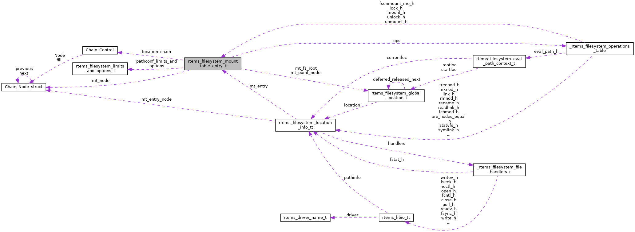

Collaboration diagram for rtems_filesystem_mount_table_entry_tt:
Collaboration graph
[legend]
rtems_chain_node mt_node
void * fs_info
const rtems_filesystem_operations_tableops
const void * immutable_fs_info
rtems_chain_control location_chain
rtems_filesystem_global_location_tmt_point_node
rtems_filesystem_global_location_tmt_fs_root
bool mounted
bool writeable
const rtems_filesystem_limits_and_options_tpathconf_limits_and_options
const char * target
const char * type
char * dev
rtems_id unmount_task
