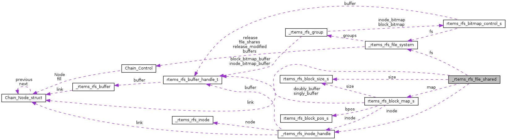

File data that is shared by various file handles accessing the same file. More...
#include <rtems-rfs-file.h>
Data Fields | |
| rtems_chain_node | link |
| The shared parts are maintained as a list. | |
| int | references |
| Reference count the users of this data. | |
| rtems_rfs_inode_handle | inode |
| The inode for the file. | |
| rtems_rfs_block_map | map |
| The block map for the file. More... | |
| rtems_rfs_block_size | size |
| The size of the file as taken from the inode. More... | |
| rtems_rfs_time | atime |
| The access time. More... | |
| rtems_rfs_time | mtime |
| The modified time. More... | |
| rtems_rfs_time | ctime |
| The change time. More... | |
| rtems_rfs_file_system * | fs |
| Hold a pointer to the file system data so users can take the handle and use it without the needing to hold the file system data pointer. | |
We hold various inode values common to the file that can change frequently so the inode is not thrashed yet we meet the requirements of the POSIX standard. The stat call needs to check the shared file data.
