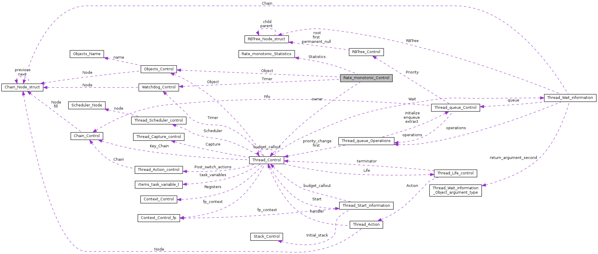

The following structure defines the control block used to manage each period. More...
#include <ratemon.h>
Data Fields | |
| Objects_Control | Object |
| This field is the object management portion of a Period instance. More... | |
| Watchdog_Control | Timer |
| This is the timer used to provide the unblocking mechanism. More... | |
| rtems_rate_monotonic_period_states | state |
| This field indicates the current state of the period. More... | |
| uint32_t | next_length |
| This field contains the length of the next period to be executed. | |
| Thread_Control * | owner |
| This field contains a pointer to the TCB for the thread which owns and uses this period instance. | |
| Thread_CPU_usage_t | cpu_usage_period_initiated |
| This field contains the cpu usage value of the owning thread when the period was initiated. More... | |
| Rate_monotonic_Period_time_t | time_period_initiated |
| This field contains the wall time value when the period was initiated. More... | |
| Rate_monotonic_Statistics | Statistics |
| This field contains the statistics maintained for the period. | |
