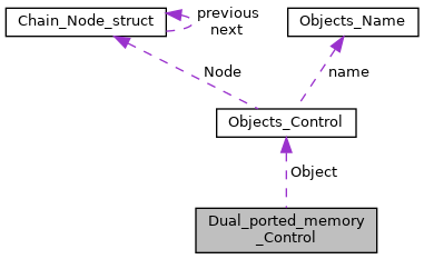

The following structure defines the port control block. More...
#include <dpmem.h>
Data Fields | |
| Objects_Control | Object |
| This field is the object management portion of a Port instance. More... | |
| void * | internal_base |
| This field is the base internal address of the port. More... | |
| void * | external_base |
| This field is the base external address of the port. More... | |
| uint32_t | length |
| This field is the length of dual-ported area of the port. More... | |
Each port has a control block associated with it. This control block contains all information required to support the port related operations.

| Objects_Control Dual_ported_memory_Control::Object |
