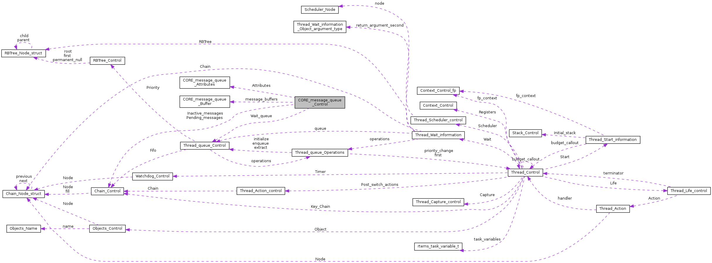

Control block used to manage each message queue. More...
#include <coremsg.h>
Data Fields | |
| Thread_queue_Control | Wait_queue |
| This field is the Waiting Queue used to manage the set of tasks which are blocked waiting to receive a message from this queue. | |
| CORE_message_queue_Attributes | Attributes |
| This element is the set of attributes which define this instance's behavior. | |
| uint32_t | maximum_pending_messages |
| This element is maximum number of messages which may be pending at any given time. | |
| uint32_t | number_of_pending_messages |
| This element is the number of messages which are currently pending. | |
| size_t | maximum_message_size |
| This is the size in bytes of the largest message which may be sent via this queue. | |
| Chain_Control | Pending_messages |
| This chain is the set of pending messages. More... | |
| CORE_message_queue_Buffer * | message_buffers |
| This is the address of the memory allocated for message buffers. More... | |
| Chain_Control | Inactive_messages |
| This chain is the set of inactive messages. More... | |
