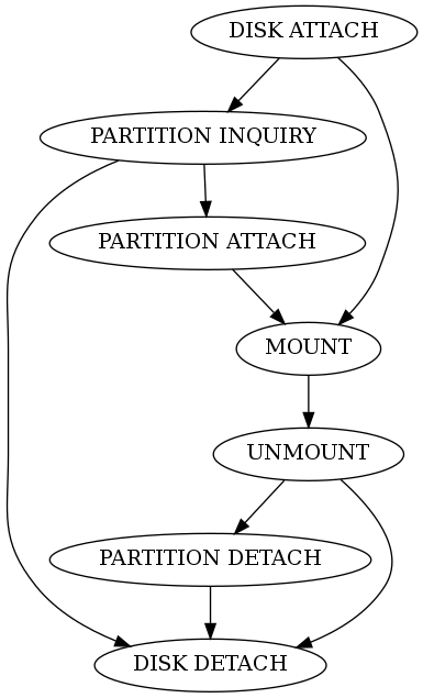

Enumerations | |
| enum | rtems_media_event { RTEMS_MEDIA_EVENT_DISK_ATTACH, RTEMS_MEDIA_EVENT_DISK_DETACH, RTEMS_MEDIA_EVENT_MOUNT, RTEMS_MEDIA_EVENT_UNMOUNT, RTEMS_MEDIA_EVENT_PARTITION_INQUIRY, RTEMS_MEDIA_EVENT_PARTITION_ATTACH, RTEMS_MEDIA_EVENT_PARTITION_DETACH, RTEMS_MEDIA_EVENT_ERROR } |
| Disk life cycle events: More... | |

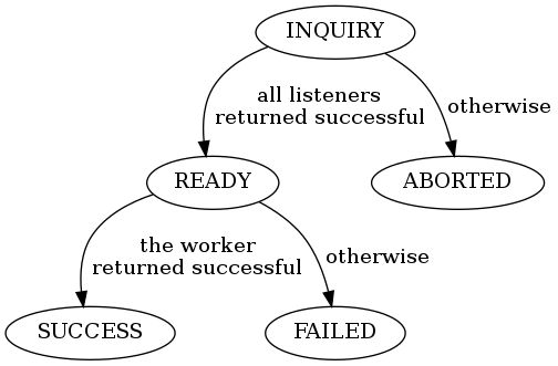

| enum | rtems_media_state { RTEMS_MEDIA_STATE_INQUIRY, RTEMS_MEDIA_STATE_READY, RTEMS_MEDIA_STATE_ABORTED, RTEMS_MEDIA_STATE_SUCCESS, RTEMS_MEDIA_STATE_FAILED, RTEMS_MEDIA_ERROR_DISK_UNKNOWN, RTEMS_MEDIA_ERROR_DISK_EXISTS, RTEMS_MEDIA_ERROR_DISK_OR_PARTITION_UNKNOWN, RTEMS_MEDIA_ERROR_DISK_OR_PARTITION_EXISTS, RTEMS_MEDIA_ERROR_PARTITION_UNKNOWN, RTEMS_MEDIA_ERROR_PARTITION_ORPHAN, RTEMS_MEDIA_ERROR_PARTITION_DETACH_WITH_MOUNT, RTEMS_MEDIA_ERROR_PARTITION_WITH_UNKNOWN_DISK, RTEMS_MEDIA_ERROR_MOUNT_POINT_UNKNOWN, RTEMS_MEDIA_ERROR_MOUNT_POINT_EXISTS, RTEMS_MEDIA_ERROR_MOUNT_POINT_ORPHAN } |
| Normal state transition: More... | |

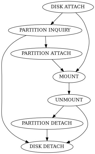

| enum rtems_media_event |

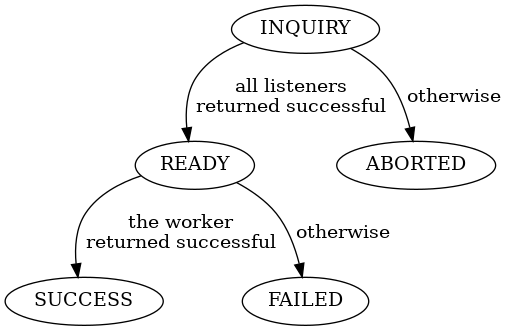

| enum rtems_media_state |
