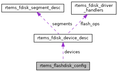

RTEMS Flash Disk configuration table used to initialise the driver. More...
