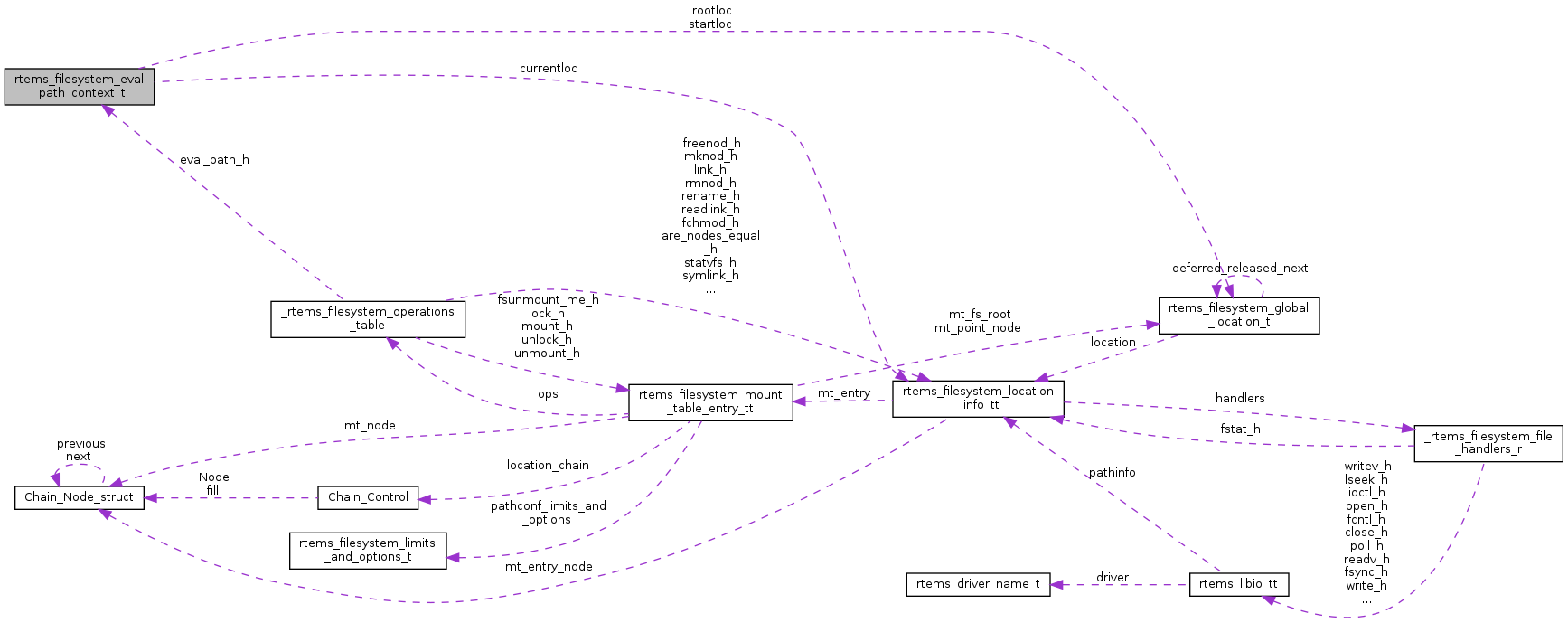

Path evaluation context. More...
#include <libio.h>
Data Fields | |
| const char * | path |
| The contents of the remaining path to be evaluated. | |
| size_t | pathlen |
| The length of the remaining path to be evaluated. | |
| const char * | token |
| The contents of the token to be evaluated with respect to the current location. | |
| size_t | tokenlen |
| The length of the token to be evaluated with respect to the current location. | |
| int | flags |
| The path evaluation is controlled by the following flags. More... | |
| int | recursionlevel |
| Symbolic link evaluation is a recursive operation. More... | |
| rtems_filesystem_location_info_t | currentloc |
| This is the current file system location of the evaluation process. More... | |
| rtems_filesystem_global_location_t * | rootloc |
| The location of the root directory of the user environment during the evaluation start. | |
| rtems_filesystem_global_location_t * | startloc |
| The start location of the evaluation process. More... | |
| rtems_filesystem_location_info_t rtems_filesystem_eval_path_context_t::currentloc |
Tokens are evaluated with respect to the current location. The token interpretation may change the current location. The purpose of the path evaluation is to change the start location into a final current location according to the path.
| int rtems_filesystem_eval_path_context_t::flags |
| int rtems_filesystem_eval_path_context_t::recursionlevel |
This field helps to limit the recursion level and thus prevents a stack overflow. The recursion level is limited by RTEMS_FILESYSTEM_SYMLOOP_MAX.
| rtems_filesystem_global_location_t* rtems_filesystem_eval_path_context_t::startloc |
The start location my change during symbolic link evaluation.
