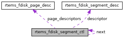

Collaboration diagram for rtems_fdisk_segment_ctl:
Collaboration graph
[legend]
struct rtems_fdisk_segment_ctlnext
 Segments with available pages are maintained as a linked list.
const rtems_fdisk_segment_descdescriptor
 The descriptor provided by the low-level driver.
uint32_t device
 The device this segment resides on.
uint32_t segment
 The segment in the device. More...
rtems_fdisk_page_descpage_descriptors
 The in-memory ocpy of the page descriptors found at the start of the segment in the flash device.
