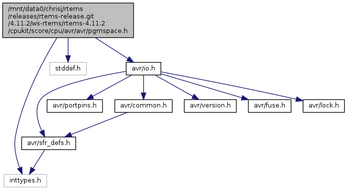

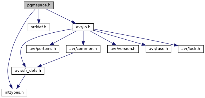

#include <inttypes.h>
#include <stddef.h>
#include <avr/io.h>
Include dependency graph for pgmspace.h:
