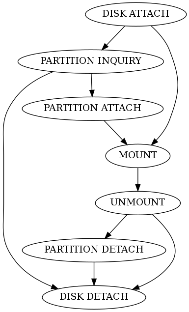

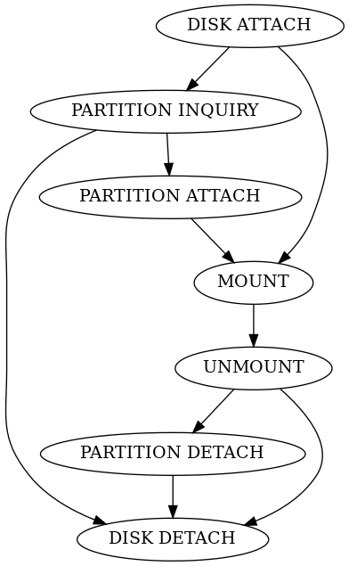

enum  rtems_media_event {
  RTEMS_MEDIA_EVENT_DISK_ATTACH, RTEMS_MEDIA_EVENT_DISK_DETACH, RTEMS_MEDIA_EVENT_MOUNT, RTEMS_MEDIA_EVENT_UNMOUNT,
  RTEMS_MEDIA_EVENT_PARTITION_INQUIRY, RTEMS_MEDIA_EVENT_PARTITION_ATTACH, RTEMS_MEDIA_EVENT_PARTITION_DETACH, RTEMS_MEDIA_EVENT_ERROR
 Disk life cycle events: More...

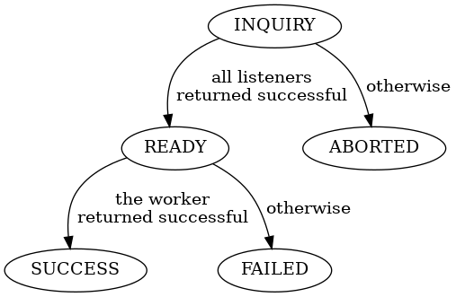

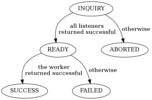

enum  rtems_media_state {
  RTEMS_MEDIA_STATE_INQUIRY, RTEMS_MEDIA_STATE_READY, RTEMS_MEDIA_STATE_ABORTED, RTEMS_MEDIA_STATE_SUCCESS,
  RTEMS_MEDIA_STATE_FAILED, RTEMS_MEDIA_ERROR_DISK_UNKNOWN, RTEMS_MEDIA_ERROR_DISK_EXISTS, RTEMS_MEDIA_ERROR_DISK_OR_PARTITION_UNKNOWN,
  RTEMS_MEDIA_ERROR_DISK_OR_PARTITION_EXISTS, RTEMS_MEDIA_ERROR_PARTITION_UNKNOWN, RTEMS_MEDIA_ERROR_PARTITION_ORPHAN, RTEMS_MEDIA_ERROR_PARTITION_DETACH_WITH_MOUNT,
  RTEMS_MEDIA_ERROR_PARTITION_WITH_UNKNOWN_DISK, RTEMS_MEDIA_ERROR_MOUNT_POINT_UNKNOWN, RTEMS_MEDIA_ERROR_MOUNT_POINT_EXISTS, RTEMS_MEDIA_ERROR_MOUNT_POINT_ORPHAN
 Normal state transition: More...
