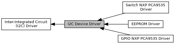

Collaboration diagram for I2C Device Driver:
 EEPROM Driver
 Driver for EEPROM device.
 GPIO NXP PCA9535 Driver
 Driver for NXP PCA9535 16-bit GPIO device.
 Switch NXP PCA9535 Driver
 Driver for NXP PCA9548A 8-channel switch device.
