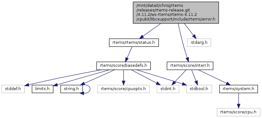

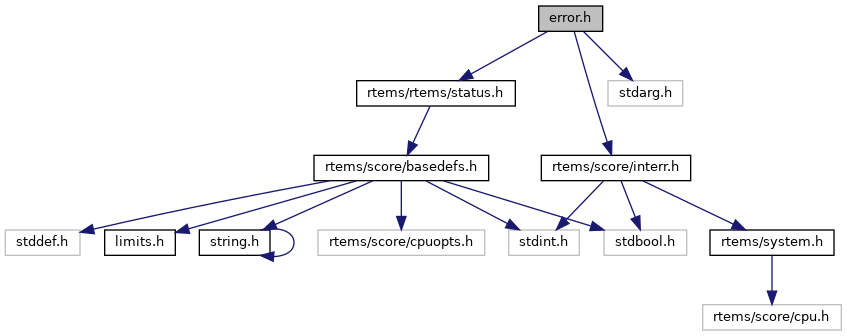

#include <rtems/score/interr.h>
#include <stdarg.h>
Include dependency graph for error.h:
