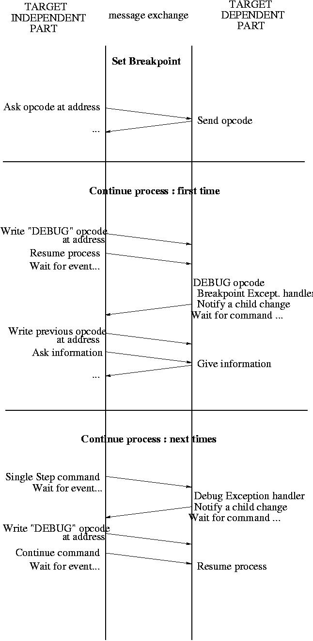

Figure Breakpoint and process execution explains how the debugger manages the breakpoints and controls the execution of a process :
  1. The host asks the debuggee what is the opcode at the concerned address in order for GDB to memorize this instruction,
  2. the host sends a CONTINUE command : it asks the target to write the ``DEBUG'' opcode (for example, the INTEL ``DEBUG'' opcode is INT3 which generate a breakpoint trap) instead of the debugged opcode.
  3. then the host waits for events,
  4. after the change of instruction, the target resumes the execution of the debuggee,
  5. when the ``DEBUG'' opcode is executed, the breakpoint exception handler is executed and it notifies the host that the process is stopped. Then it waits for commands (if no command is sent after a certain amount of time, the connection will be closed by the target).
  6. the host asks the target to re-write the right opcode instead of the ''DEBUG'' opcode and then can ask information
Figure Breakpoint and process execution also shows the case of other ``CONTINUE'' commands (remember that the ``DEBUG'' opcode has been replaced by the right instruction):
  1. Host sends first a ``single step'' command to execute the debugged instruction,
  2. It then waits for ``single step`` exception event,
  3. the target, once the single step executed, calls the debug exception handler. It notifies the host that execution is suspended and wait for commands.
  4. the host asks the target to re-write the ``DEBUG'' opcode (breakpoint trap) instead of the debugged one.
  5. then the host sends a ``CONTINUE'' command in order the target to resume the process execution to the next breakpoint.
