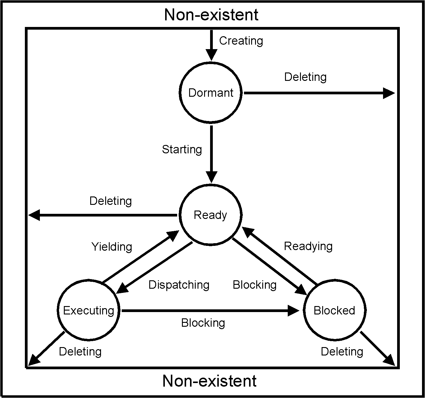

Tasks in an RTEMS system must always be in one of the five allowable task states. These states are: executing, ready, blocked, dormant, and non-existent.
A task occupies the non-existent state before a
rtems_task_create has been
issued on its behalf. A task enters the
non-existent state from any other state in the system when it is
deleted with the rtems_task_delete
directive. While a task occupies
this state it does not have a TCB or a task ID assigned to it;
therefore, no other tasks in the system may reference this task.
When a task is created via the rtems_task_create directive
it enters the dormant state. This state is not entered through
any other means. Although the task exists in the system, it
cannot actively compete for system resources. It will remain in
the dormant state until it is started via the rtems_task_start
directive, at which time it enters the ready state. The task is
now permitted to be scheduled for the processor and to compete
for other system resources.
A task occupies the blocked state whenever it is
unable to be scheduled to run. A running task may block itself
or be blocked by other tasks in the system. The running task
blocks itself through voluntary operations that cause the task
to wait. The only way a task can block a task other than itself
is with the rtems_task_suspend directive.

A task occupies the ready state when it is able to be scheduled to run, but currently does not have control of the processor. Tasks of the same or higher priority will yield the processor by either becoming blocked, completing their timeslice, or being deleted. All tasks with the same priority will execute in FIFO order. A task enters the ready state due to any of the following conditions:

A ready task occupies the executing state when it has control of the CPU. A task enters the executing state due to any of the following conditions:
