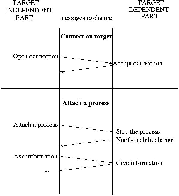

This structure contains pointers to functions (in C++, this would be called a virtual class). Each different target supported by GDB has its own structure with the relevant implementation of the functions (some functions may be not implemented). When a user connects GDB to a target via the ``target'' command, GDB points to the structure corresponding to this target. Then the user can attache GDB to a specific task via the ``attach'' command. We have therefore identified two steps to begin a remote debug session :
Figure Debug session initialization explains how the debugger connects to the target :

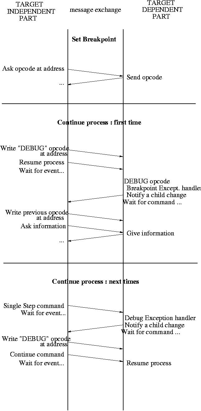

Figure Breakpoint and process execution explains how the debugger manages the breakpoints and controls the execution of a process :
Figure Breakpoint and process execution also shows the case of other ``CONTINUE'' commands (remember that the ``DEBUG'' opcode has been replaced by the right instruction):

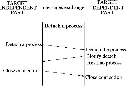

Figure Detach a process and close a connection explains how the debugger disconnects from a target :
