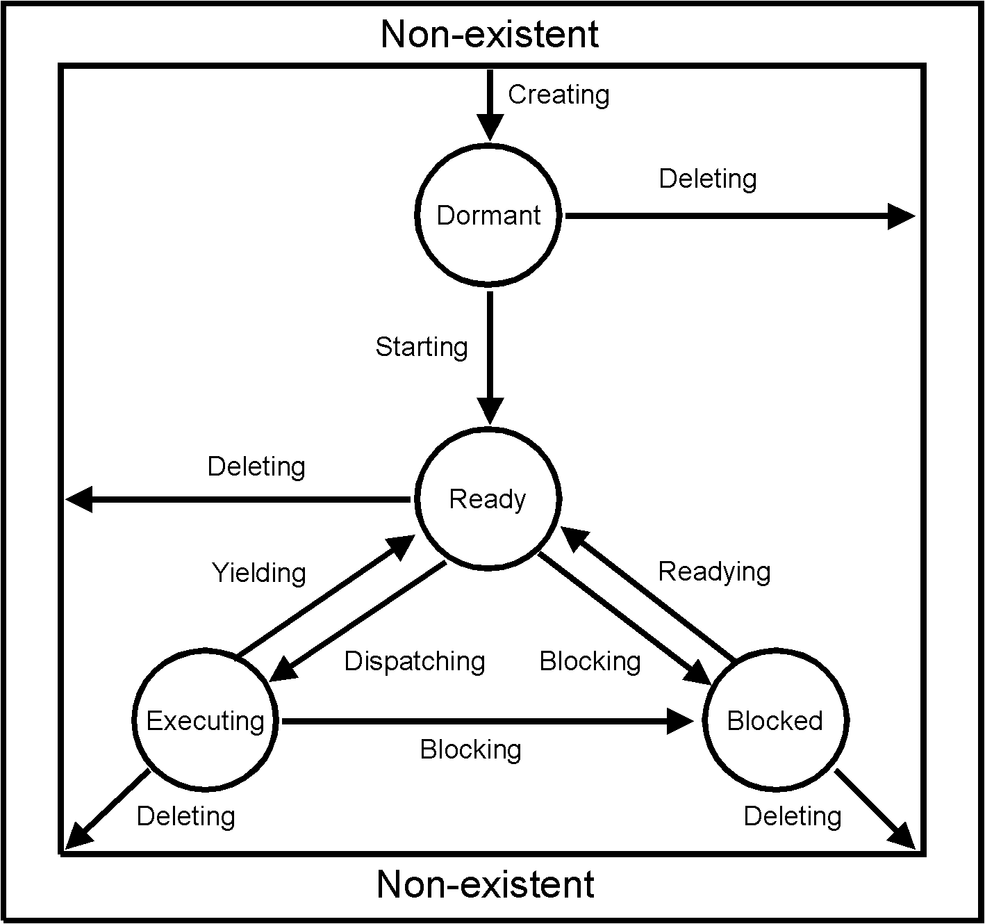

Tasks in an RTEMS system must always be in one of the five allowable task states. These states are: executing, ready, blocked, dormant, and non-existent.
A task occupies the non-existent state before a
rtems.task_create has been
issued on its behalf.  A task enters the
non-existent state from any other state in the system when it is
deleted with the rtems.task_delete
directive.  While a task occupies
this state it does not have a TCB or a task ID assigned to it;
therefore, no other tasks in the system may reference this task.
When a task is created via the rtems.task_create directive
it enters the dormant state.  This state is not entered through
any other means.  Although the task exists in the system, it
cannot actively compete for system resources.  It will remain in
the dormant state until it is started via the rtems.task_start
directive, at which time it enters the ready state.  The task is
now permitted to be scheduled for the processor and to compete
for other system resources.
A task occupies the blocked state whenever it is
unable to be scheduled to run.  A running task may block itself
or be blocked by other tasks in the system.  The running task
blocks itself through voluntary operations that cause the task
to wait.  The only way a task can block a task other than itself
is with the rtems.task_suspend directive.
A task enters the blocked state due to any of the following conditions:
which blocks either itself or another task in the system.
rtems.message_queue_receive
directive with the wait option and the message queue is empty.
rtems.event_receive
directive with the wait option and the currently pending events do not
satisfy the request.
rtems.semaphore_obtain
directive with the wait option and the requested semaphore is unavailable.
rtems.task_wake_after
directive which blocks the task for the given time interval.  If the time
interval specified is zero, the task yields the processor and
remains in the ready state.
rtems.task_wake_when
directive which blocks the task until the requested date and time arrives.
rtems.region_get_segment
directive with the wait option and there is not an available segment large
enough to satisfy the task's request.
rtems.rate_monotonic_period
directive and must wait for the specified rate monotonic period
to conclude.
A blocked task may also be suspended. Therefore, both the suspension and the blocking condition must be removed before the task becomes ready to run again.
A task occupies the ready state when it is able to be scheduled to run, but currently does not have control of the processor. Tasks of the same or higher priority will yield the processor by either becoming blocked, completing their timeslice, or being deleted. All tasks with the same priority will execute in FIFO order. A task enters the ready state due to any of the following conditions:
rtems.task_resume
directive for a task that is suspended and the task is not blocked
waiting on any resource.
rtems.message_queue_send,
rtems.message_queue_broadcast, or a
rtems.message_queue_urgent directive
which posts a message to the queue on which the blocked task is
waiting.
rtems.event_send
directive which sends an event condition to a task which is blocked
waiting on that event condition.
rtems.semaphore_release
directive which releases the semaphore on which the blocked task is
waiting.
rtems.task_wake_after directive.
rtems.task_wake_when directive.
rtems.region_return_segment
directive which releases a segment to the region on which the blocked task
is waiting and a resulting segment is large enough to satisfy
the task's request.
rtems.rate_monotonic_period directive.
rtems.task_restart
directive for the blocked task.
A ready task occupies the executing state when it has control of the CPU. A task enters the executing state due to any of the following conditions:
