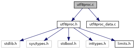

utf8proc.c File Reference
#include "utf8proc.h"
#include "utf8proc_data.c"
Include dependency graph for utf8proc.c:
