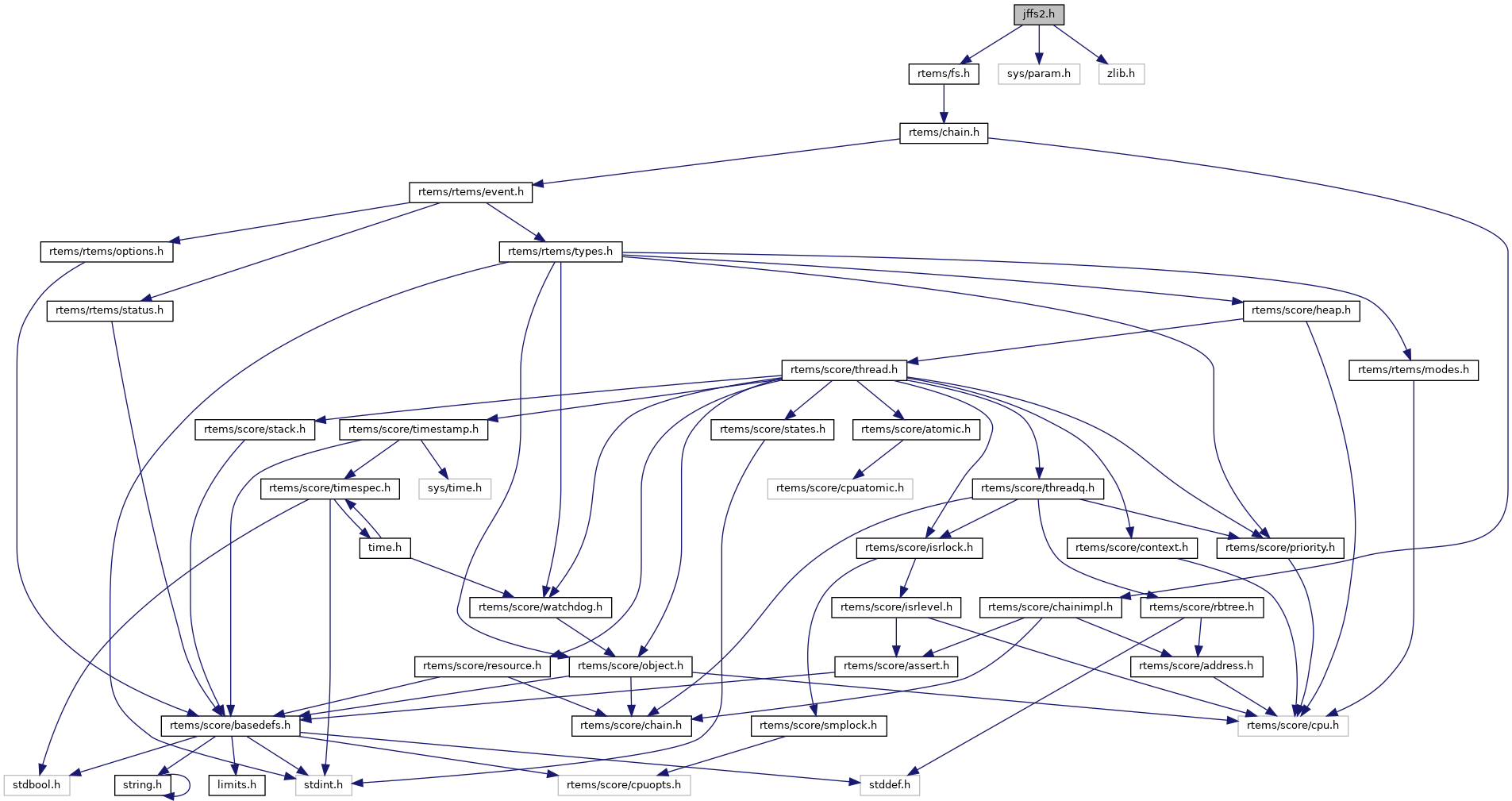

#include <rtems/fs.h>
#include <sys/param.h>
#include <zlib.h>
Include dependency graph for rtems/jffs2.h:
