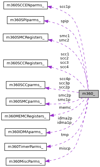

unsigned char | dpram0 [0x400] |
unsigned char | dpram1 [0x200] |
unsigned char | dpram2 [0x100] |
unsigned char | dpram3 [0x100] |
unsigned char | _rsv0 [0xC00-0x800] |
m360SCCENparms_t | scc1p |
unsigned char | _rsv1 [0xCB0-0xC00-sizeof(m360SCCENparms_t)] |
m360MiscParms_t | miscp |
unsigned char | _rsv2 [0xD00-0xCB0-sizeof(m360MiscParms_t)] |
m360SCCparms_t | scc2p |
unsigned char | _rsv3 [0xD80-0xD00-sizeof(m360SCCparms_t)] |
m360SPIparms_t | spip |
unsigned char | _rsv4 [0xDB0-0xD80-sizeof(m360SPIparms_t)] |
m360TimerParms_t | tmp |
unsigned char | _rsv5 [0xE00-0xDB0-sizeof(m360TimerParms_t)] |
m360SCCparms_t | scc3p |
unsigned char | _rsv6 [0xE70-0xE00-sizeof(m360SCCparms_t)] |
m360IDMAparms_t | idma1p |
unsigned char | _rsv7 [0xE80-0xE70-sizeof(m360IDMAparms_t)] |
m360SMCparms_t | smc1p |
unsigned char | _rsv8 [0xF00-0xE80-sizeof(m360SMCparms_t)] |
m360SCCparms_t | scc4p |
unsigned char | _rsv9 [0xF70-0xF00-sizeof(m360SCCparms_t)] |
m360IDMAparms_t | idma2p |
unsigned char | _rsv10 [0xF80-0xF70-sizeof(m360IDMAparms_t)] |
m360SMCparms_t | smc2p |
unsigned char | _rsv11 [0x1000-0xF80-sizeof(m360SMCparms_t)] |

m360MEMCRegisters_t | memc [8] |

m360SCCRegisters_t | scc1 |
m360SCCRegisters_t | scc2 |
m360SCCRegisters_t | scc3 |
m360SCCRegisters_t | scc4 |
m360SMCRegisters_t | smc1 |
m360SMCRegisters_t | smc2 |
