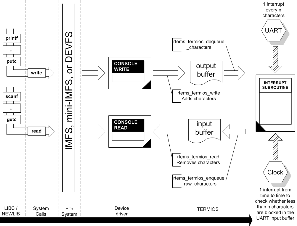

  • The following Figure shows how a Termios driven serial driver works:
    Termios Flow
    The following list describes the basic flow.
